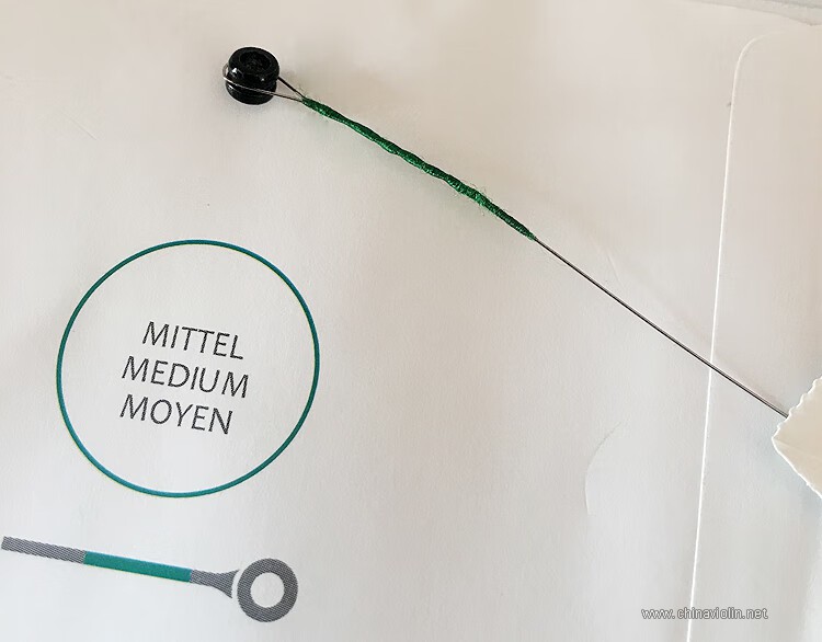

尼龙弦不像钢弦,开始很容易走音,所以调弦比较麻烦点
Recommendations and Tips: For optimal response after putting on a set, all the strings should be cleaned before playing with a dry cloth. A microfibre cloth is especially recommended. To enhance stability and readiness for concert use, each string should be slightly warmed after being changed and tuned up by sliding your thumb up and down the string about five times, applying light pressure. The instrument should then be re-tuned and this process repeated three times. Bowing near the bridge with considerable pressure (up bow and down bow about five times each) will make the strings ready for concert use in the shortest time possible. Experience has shown that strings prepared in this way can be made concert-ready in as little as two to three hours. However it should be noted that these preparatory measures can shorten the sonic life span of the strings and should only be used if circumstances demand the shortest possible preparatory time.
以上摘自Thomastik Infeld牌琴弦的网站
大概的要点是:
为了让你的尼龙弦尽快进入演奏状态,可以这样做
定弦的时候要先用手指在弦上来回滑几次,让弦暖起来 然后开始定弦
用大的压力在近琴马的地方调弦 来回多拉几次 然后反复调3次弦 (真够麻烦的。。。)
不过值得注意的是这个办法对琴弦的寿命有损(不过损不了多少,为了拿起琴来就能拉还是值得的),如果不是迫不得已,最好少用
