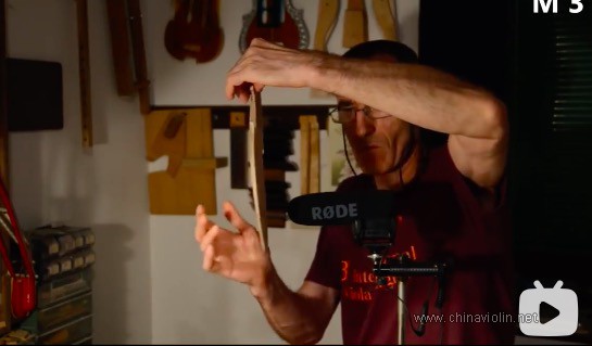

最近看到一个意大利制琴师用测试敲击面板和背板音频的方式来制定厚度,而不是统一的固定厚度,毕竟每个木头的密度是不一样的,所以下载了下来 分享给大家,
https://www.bilibili.com/video/BV14Y411G7Uv/

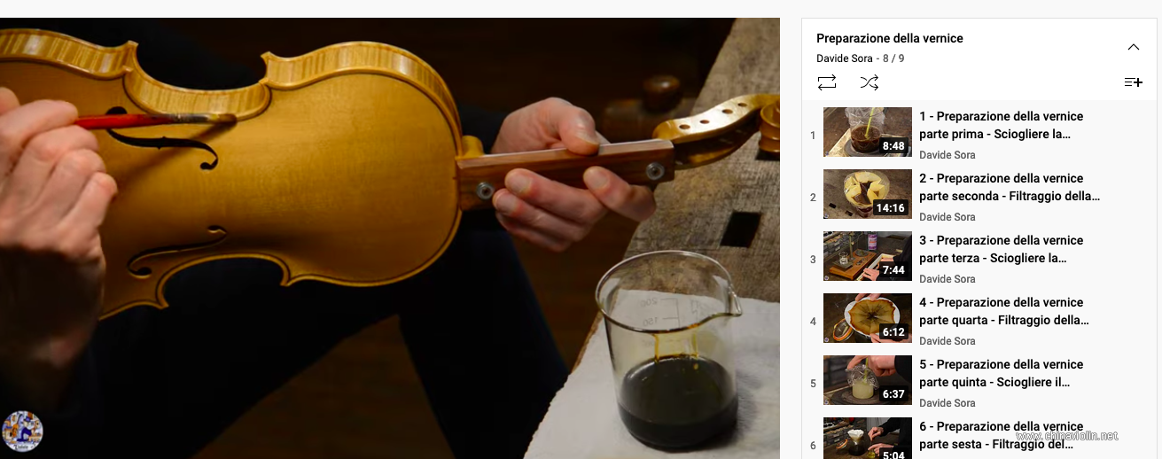

我给这位伟大的制琴师留言了,我问他是否可以把小提琴从白胚到成品的全部上漆过程和制漆过程做一个系列,他说没问题的,但是花费一些时间,我相信这么详细且正规的制作过程,网上资料很少吧,以下是他的回复:
Well, that would be a lot of videos that would take a long time to make, considering the whole varnishing process takes me about a month. but sooner or later I will make them, for the moment you can see the ones I have already done in these two playlist:
https://www.youtube.com/watch?v= ... FX9UDBNlQlvRjkItIwi
https://www.youtube.com/watch?v= ... Wa62vyXkBgcBOK0YnIg
Regarding the explanation of the various phases, it is much quicker and simpler:
1-finishing the wood with scrapers only (which is an integral part of the varnishing)
2-tanning of wood with UV lamps (about 300 hours)
3-application of the protein sealer
4-primer application (or not, it depends on the previous wood color you get with tanning, usually I do not need a primer)
5-application of the non-pigmented varnish (5 or 6 coats)
6-blackening of the chamfers
7-application of the colored varnish (pigmented, 10 or 12 coats)
8-touch-up of the colored varnish
9-application of the final protective varnish (non-pigmented, 10 or 12 coats)
10-sanding
11-final application with pad (with the same non-pigmented varnish, similar to what is called "french polishing")
12-polishing with some sort of polish (or not, if you are fine with the results of the previous step)
看来我的油漆有着落了。  详情 回复 发表于 2022-3-7 13:18
