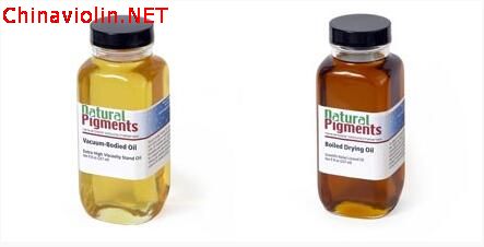

上面左边是隔绝氧气热处理的亚麻油bodied oil,右边是熟化亚麻油boiled oil,二者颜色有显著差别。
