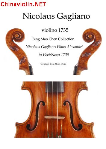

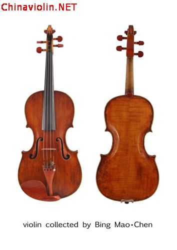

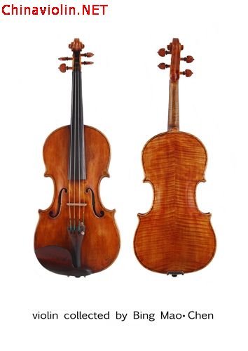

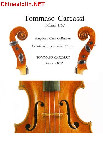

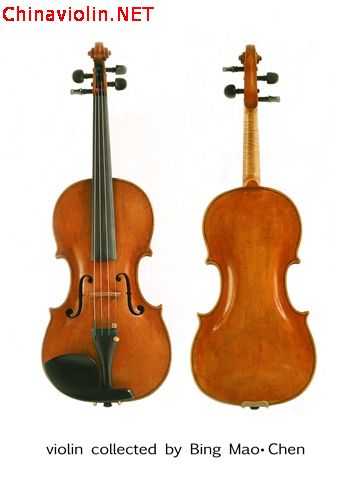

采访临近尾声,陈教授拿出几张自己收藏的提琴照片,让大家先睹为快!并祝愿提琴展越办越好!

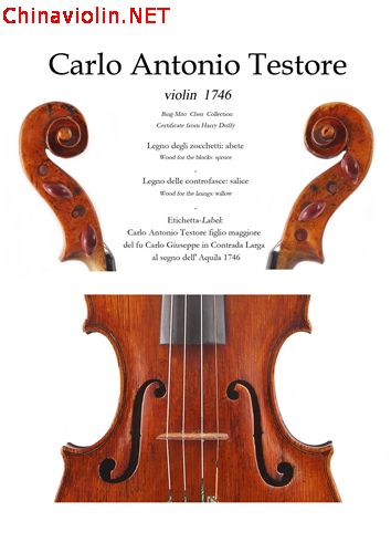

Antonio Testore violin
cacassi violin

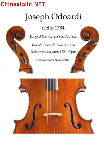

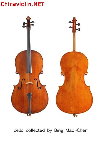

Joseph cello
nicolua violin

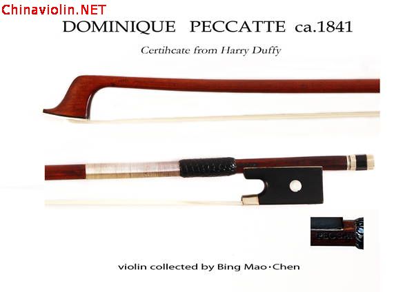

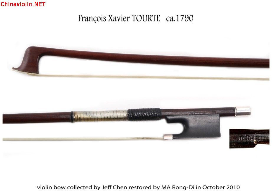

peccatte bow
