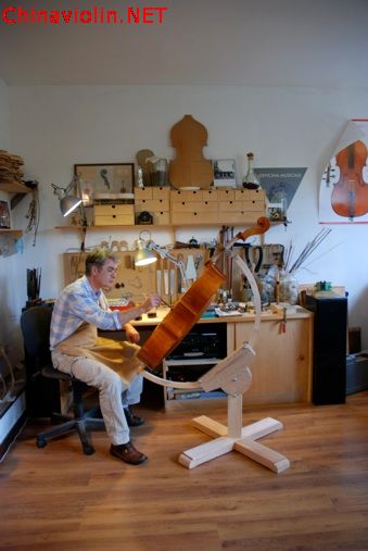

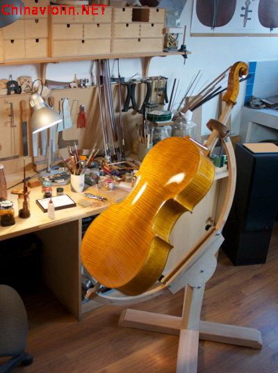

2010年秋天,英国杂志《斯特拉底》The Strad 的编辑问了贝童大师一个非常特别的问题:哪种(迄今还未发明出来的)工具你一定会买?你可以充分发挥你的想象力来回答这个问题。我们想听听你对工具最古怪的想法!
贝童当时已经想象出了一个能够让大提琴在三根轴上转动而不离开夹具的铰接式大提琴架。这类的支撑在大提油漆、装配等时候特别方便好用。于是他付诸行动,便有了现在的成果。
During Spring 2010, the redaction of the famous british magazine -The Strad- contacted me for a very particular inquiry; - What tool (which hasn’t been invented yet) would you definitely buy? You can let your imagination run riot with this question – we would like to hear about the wackiest idea for a tool you have!
I already had imagined an articulated cello stand which gives the possibility to rotate the cello in her three axes without leaving her stand clamps. This kind of support often misses in varnishing, retouching, or fitting time. So I made it and here is the result.
