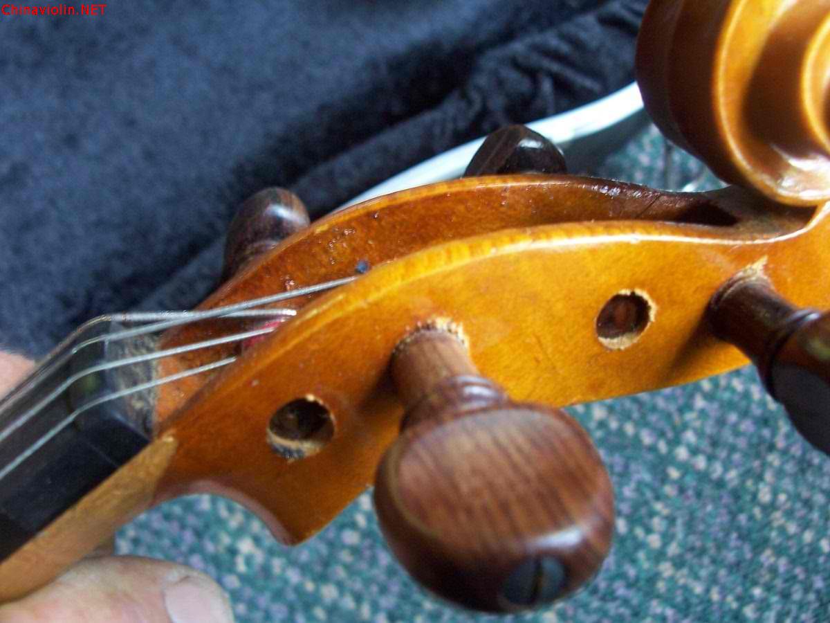

 看到一种提琴弦轴,如图,一面烙有“Caspario”,另一面是“Patent”(专利) ,不知是怎么回事,在网上也没有搜到,哪位能给解释一下?谢谢!

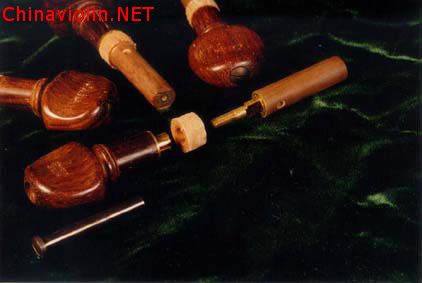

找到了一些图。还请用过的网友解释一下如何使用,谢谢!

Caspari: These European pegs look very much like conventional wooden pegs, but they have a built-in clutch to control the peg from slipping. This clutch can be controlled with an adjustment screw in the end of the peg's handle. These are often installed in beginner's violins and violas and are very finely crafted from rosewood. Except for occasional adjustment of the clutch, they should be trouble-free. Adjust so the peg is just barely holding the tension of the string without slipping. Properly adjusted, the peg should turn readily, easily, and smoothly to tighten or loosen the string. The instrument fitted with Caspari pegs is often also fitted with fine tuners, to allow quicker tuning.

根据结构分析,穿过轴心,带平口螺帽的圆柱件是端头带母丝的螺杆,是金属材料;白色物为内外都带锥度的空心圆台,白色圆台应是揉弦材料;同白色物连接的旋钮处也带锥度;其作用是通过调节所述螺杆来调节松紧度
  ——没见过实物,纯属分析。望知情者指正。

 楼主| 发表于 2012-7-18 01:32:00 | 显示全部楼层
多谢各位。刚淘的一把琴是这样的琴轴,有一个有点跑音,调节了几次螺丝效果不是很好。只跑半调,固然可以用微调调过来,还是想弄清怎么回事的好。

发表于 2012-7-18 11:26:00 | 显示全部楼层
以下是引用明月山人在2012-7-18 1:32:00的发言:
建议:同白色物连接的旋钮处(圆台面)涂一层环氧树脂胶。

以前的一个帖子里看见过 带有微调的 据说这样可以保证有效弦长
